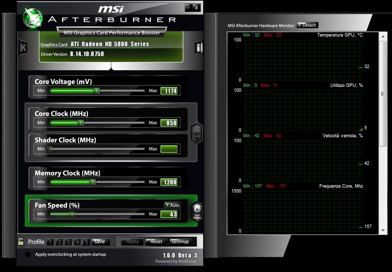

    changelog:
    • New MSI On-Screen Display Server v3.7.0 beta 10 with the following improvements:
    • Improved race condition protection system for the systems running multiple OSD applications simultaneously (e.g. OSD server, FRAPS and STEAM In-Game
      Chat)
    • Improved floating injection address hooking technology. Due to more advanced
      built-in code analyzer hooks can be injected deeper into 3D application code
      if stealth mode is enabled. These changes improve stealth mode compatibility
      with third party tools using similar stealth injection technologies (e.g.
      FRAPS v2.9.8 and newer)
    • Now stealth mode cannot be toggled during 3D application runtime to reduce
      the risk of crashing 3D application
    • Removed single screen capture per second limitation
    • Updated profiles list
    • Updated Dutch localization
    L'archivio scaricabile dal link in calce contiene anche la v.1.06 di Kombustor
    download http://event.msi.com/vga/afterburner...up160Beta3.rar

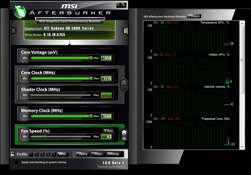

    beta 4...
    Afterburner 1.6.0 Beta 4 is released, in this version Unwnider add 2 exciting features. One is highly expected GeForce GTX 480 over-voltage function, the other is special "CaptureVoltageDefault" for AMD 5800 series BIOS issue.
    [GeForce GTX 480 Over-Voltage] In Afterburner 1.6.0 Beta 4, you can adjust the voltage of GeForce GTX 480 from 0.825~1.125V. It's not very big adjustment range, but considering egg-cooking capability of GeForce GTX 480, it is safe to stay in this range.
    GeForce GTX 470 over-voltage support will be ready in next version.
    In Afterburner, we use a hidden BIOS ID database to identify each card and define voltage adjustment range. The negative comment is right, the PWM on R5830 Twin Frozr II is up6206 which doesn't support I2C voltage adjustment, that's why we add another up6266 I2C chip to support over-voltage. All MSI R5800 series support over-voltage, we can guarantee that!
    1. Edit MSIAfterburner.cfg
    2. Change AllowCaptureVoltageDefaults from 0 to 1
    3. Run Kombustor in windowed mode
    4. Press + + + to capture voltage
    5. Done!
    Download:http://event.msi.com/vga/afterburner...up160Beta4.rar
