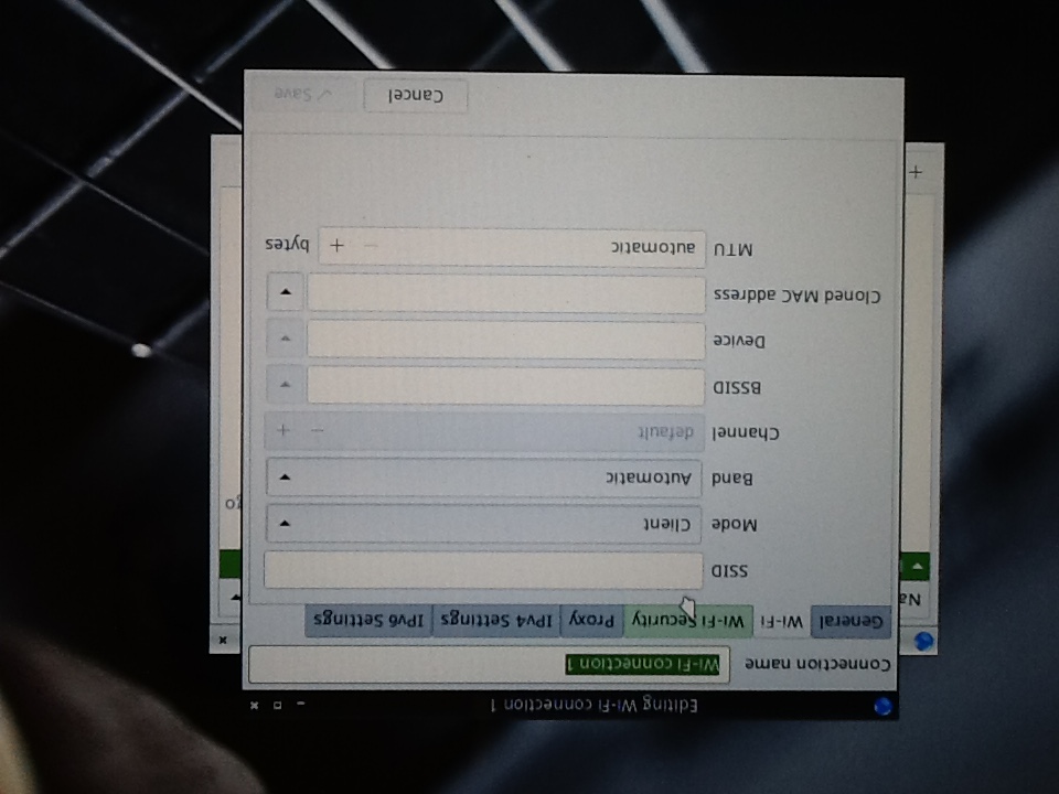

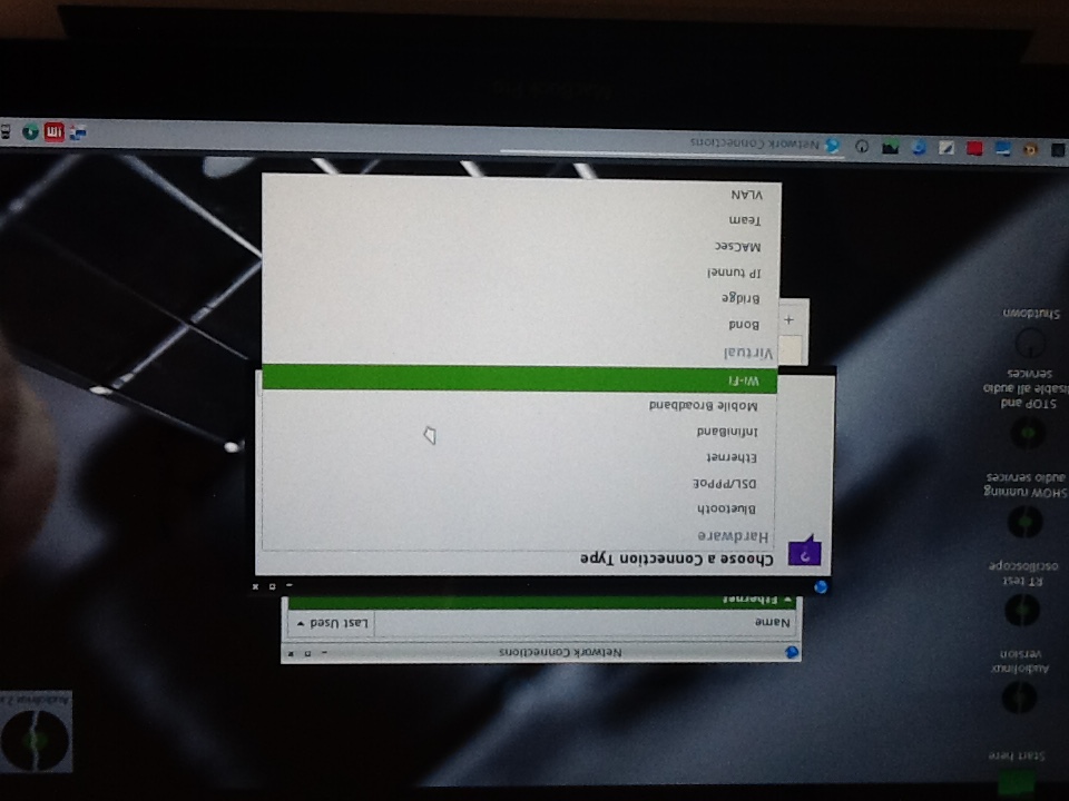

  3. #373
    Oct 2018
    49
    5
    Predefinito Enabling Wifi on AL
    Hey Guys,
    Could someone please advise how I could get wifi started on my comp. I'm running AL/Ramboot on my MacBook Pro & I wish to try out Roon as a dual PC setup and to control it via a remote (iPhone/iPad). Otherwise I have no need for wifi, Ethernet works flawlessly when I plugin the Ethernet cable.
    Please see pics, is there some filing in the blanks I need to do...
    Thanks
    Icone allegate Icone allegate AudioLinux - un nuovo Sistema Operativo per HQPlayer, ma non solo-image.jpg   AudioLinux - un nuovo Sistema Operativo per HQPlayer, ma non solo-image.jpeg   AudioLinux - un nuovo Sistema Operativo per HQPlayer, ma non solo-image.jpeg
  4. #374
    kibibyte
    Apr 2014
    269
    The wiki on archlinux is a little complex. Take a look on Fedora wiki:
    https://docs.fedoraproject.org/en-US...matically.html
