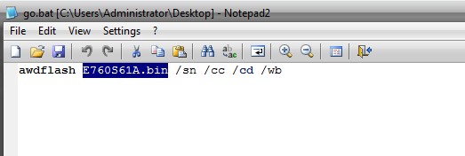

    per flashare da DOS :
    download tools :
    Windows 98 BootFile
    HP USB Disk Storage Format Tool v2.1.8.exe
    Come rendere avviabile una penna USB
    Credit to Gerri
    http://www.nexthardware.com/guide/ut...-penna-usb.htm
    Copy and paste to USB root
    AWDFLASH.EXE
    E760S61A.bin (or any .bin bios)
    Go.bat
    boot with your usb and just write :
    go.bat
    you can use go.bat for any bios flashing just edit .bat and change Bios name you wnat to flash
    PS :
    you can use it for all bios flashing videos Or other boards ....
    example : for Ati4890
    change command line to
    atiflash -f -p 0 4890.bin
    save as go.bat
    copy and paste 4890.bin + atiflash.exe in your bootable usb drive
    and flash your card

    era un esempio può essere un altro extension lasciami arrivare casa vi preparo una guida una volta per sempre..
