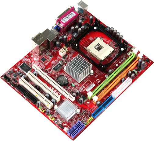

    Ragazzi vi presento l'UNICA mainboard con chipset 945 per socket 478!
    Cominciamo con un paio di foto e l'elenco delle features preso dal sito ufficiale MSI:
    CPU
    • Supports Intel® P4 Northwood/Prescott/Celeron processors.
    • Supports FSB 533/ 800MHz.
    ChipsetIntel® 945GC Chipset
    - Integrated Intel® GMA 950 graphics core
    Intel® ICH7 Chipset
    - Hi-Speed USB (USB2.0) controller, 480Mb/sec, up to 8 ports.
    - 4 SATAII ports with transfer rate up to 3Gb/s.
    - 1 channel Ultra ATA 100 bus master IDE controller.
    - PCI Master v2.3, I/O APIC.
    Main Memory
    • Supports two unbuffered DIMM of 1.8 Volt DDR2 SDRAM
    • Supports dual channel DDR2 memory architecture.
    • Supports DDR2 533/667 memory interface. (4GB Max)
    Slots
    • One PCI Express x16 slot.
    • Two 32-bit v2.3 master PCI bus slots. (support 3.3v/5v PCI bus interface)
    On-Board IDE/SATA
    • One Ultra DMA 66/100 IDE controllers integrated in ICH7
    - Supports PIO, Bus Master operation modes.
    - Can connect up to two Ultra ATA drives.
    • SATAII controller integrated in ICH7
    - Up to 3Gb/s transfer speed.
    - Can connect up to four SATAII devices.
    Audio
    • Chip integrated by Realtek® ALC888
    - Flexible 7.1-channel audio with jack sensing
    - Compliant with Azalia 1.0 Spec
    LAN
    • Supports 10 / 100 Mb/s Fast Ethernet by Realtek RTL8101E.
    • Supports 10 / 100 /1000 Mb/s Fast Ethernet by Realtek RTL8111C.
    - Supports ACPI Power Management.
    Internal I/O Connectors
    - ATX 24-Pin power connector
    - 4-pin ATX 12V power connector
    - 1 x CPU / System x 2 FAN connectors
    - CD-in connector
    - Front panel audio connector
    - 2 x Front panel connectors
    - 2 x USB 2.0 connector support additional 4 ports
    - 1 x Floppy disk drive connector
    - 4 x Serial ATAII connectors
    - 1 x ATA100 connector
    - 1 x SPDIF-out connector
    - Chassis intrusion switch connector
    - Clear CMOS jumper
    Back Panel I/O Ports
    - 1 x Parallel port
    - 1 x Serial port (COM 1)
    - 1 x Graphics Card port
    - 1 x PS/2 keyboard
    - 1 x PS/2 mouse
    - 1 x 6 in 1 audio jack
    - 4 x USB 2.0 ports
    - 1 x RJ45 LAN jack
    BIOS
    • The mainboard BIOS provides "Plug & Play" BIOS which detects the peripheral devices and
    expansion cards of the board automatically.
    • The mainboard provides a Desktop Management Interface(DMI) function which records your
    mainboard specifications.
    Dimension
    • 24.5cm(L) x 20.0cm(W) Micro-ATX Form Factor
    Mounting
    • 6 mounting holes.

    hehe quello che dici è giusto ma potrebbe anche essere una possibilità di upgrade (molto economico) per chi ha mainboard molto scarse ed ha cmq una cpu ancora decente per l'uso di tutti i giorni.
    La mobo del pc di mio padre si è fritta ed ho preso questa qui (anche per curiosità a dire il vero ) con 2 banchi da 1 giga di ram 667 mantenendo la vecchia cpu (P4 2.8 con fsb 533).
    Chiaro non è una mobo da bench ed ho sudato per trovare qualche info online così metto tutto qui nel caso possa essere utile a qualcuno
    Considera che questa ha su un discreto ICH7 ed uno slot Pci Express 16X non è male per un P4 478!
